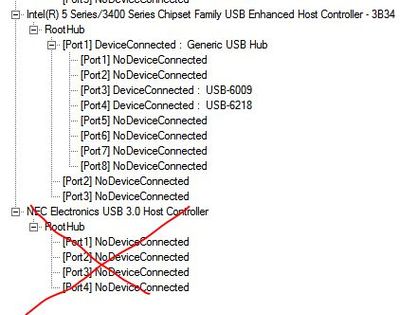

I had a similar issue, with the USB6009 throwing a 50405 error on a reset in MAX. Simply moving from a 3.0 host controler to the 3400 series chip set port solved it for me. Both are internal to my laptop (Dell EliteBook 8540w)
Using:
NiDAQ9.6.1
Window 7 x64 SP1
