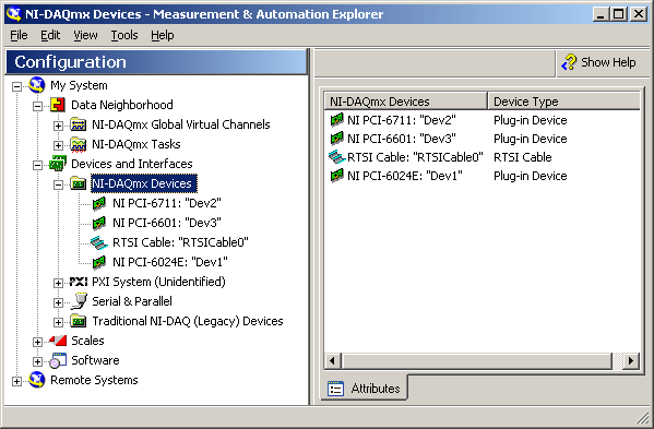

As you can see here, I do indeed have DAQmx devices as well as some virtual channels and tasks.

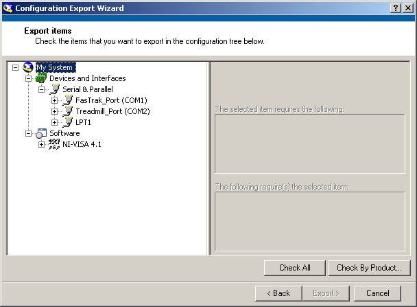

And here you can see the second page in the export wizzard after choosing to export the file as an NI Configuration Export File(*.nce).  You can see that there is nothing DAQmx-related to choose from in the tree to the left.

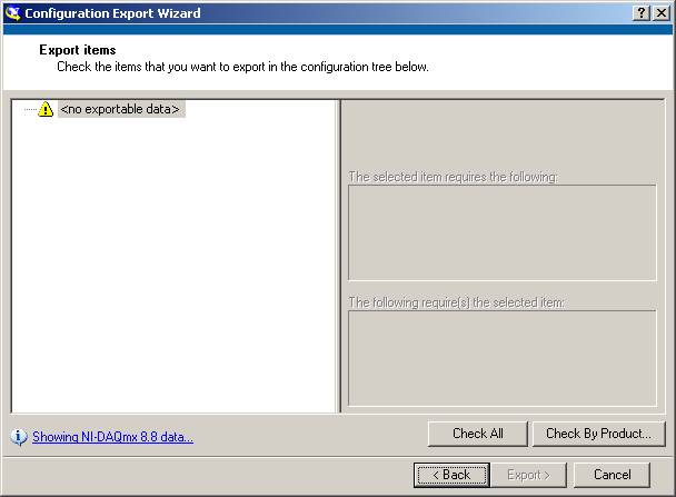

And here is the second page after selecting either an *.ini or *.txt file as the file type.
