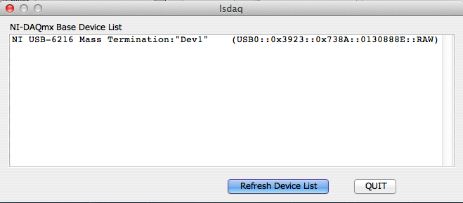

I also have a 2012 OSX MacBook (Air, not Pro Retina) and a USB 6216 that is currently working with DAQmx Base 3.6.0. What version of DAQmx Base are you working with? What connectivity do you have (OEM, mass term, screw terminal, BNC)? When you plug in your 6216 what does your Isdaq application display? For reference, this is what mine looks like:

The part on the lsdaq is the most interesting for me: my lsdaq shows no boards at all (it shows something similar if I connect a 6008 board so it is working), but the mac detects an USB device (listed as vendor specific) as:
