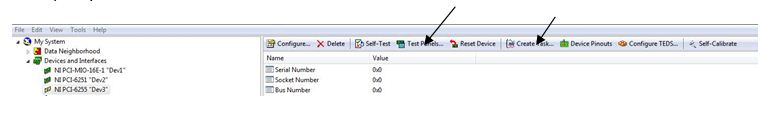

  1. Have you attempted to take a measurement using the MAX Test Panel or Create Task. This can be done by clicking on the test panels or create task option show in the picture below. Please take a measurment and see if you get the same error (50204).
