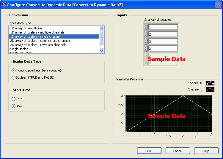

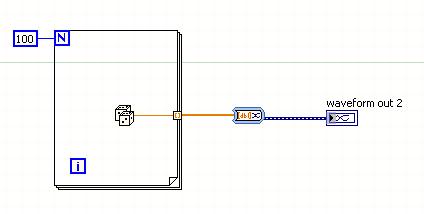

I am trying to do something similar but, from my waveform, I average 100 values, then I want to plot the averages vs. a timestamp.  Since my data is no longer a true waveform, I can't use the "build waveform" VI.  Is there another way to do this for my data?
Thanks!
(4,593 Views)
Hello Adwhit
With the Convert to Dynamic Data type config like this.
Phil
