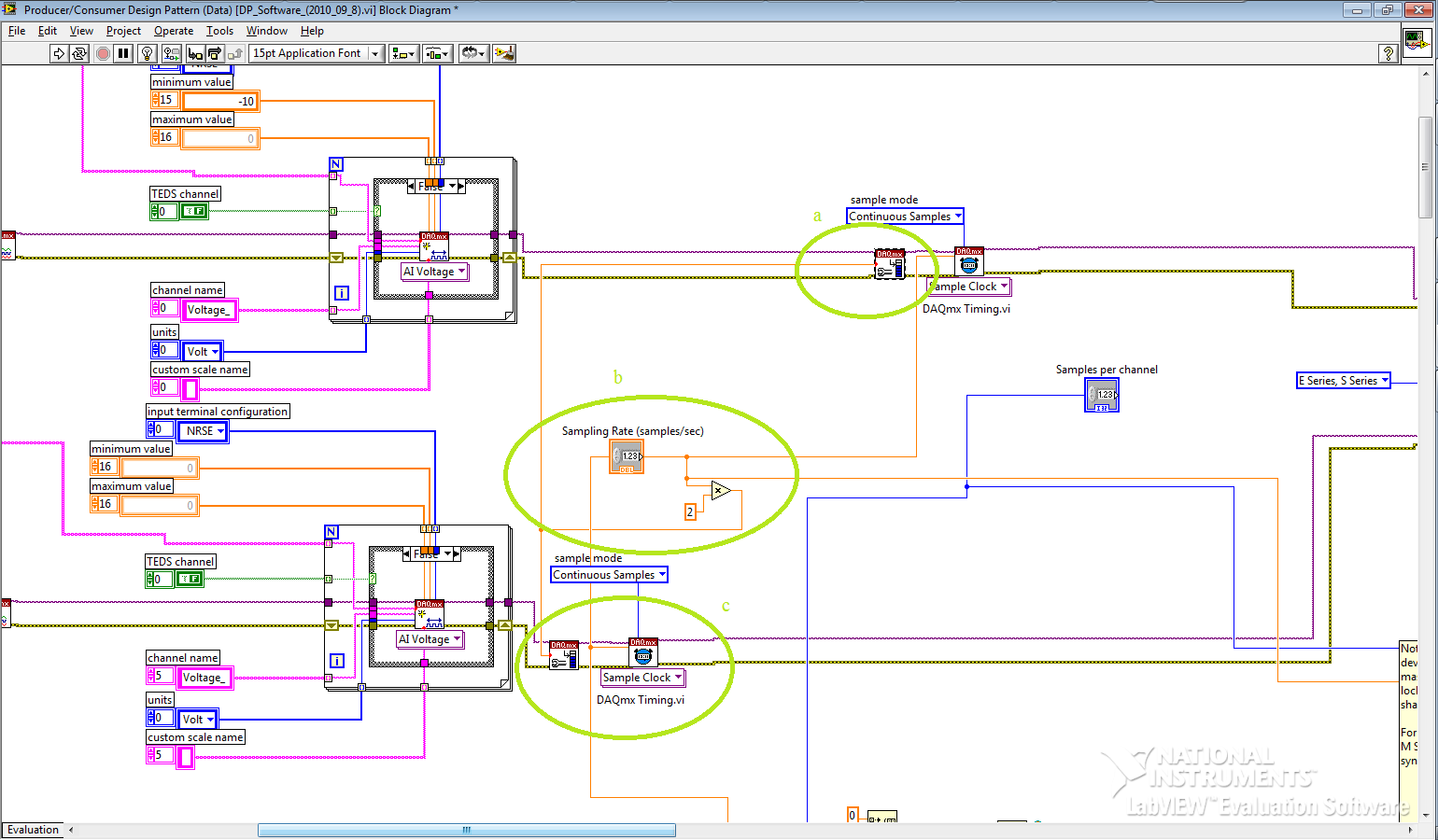

What I dont understand is that in the data sheet for the NI6070e the input buffer (FIFO) is stated to be 512 samples. However in the software i am able to set the buffer size of the DAQ's to greater than 512 samples. See Fig 1 the circles enclosed by 'a' and 'c'. I always set the buffer size equal to 2 times greater than the sampling rate I use as shown by 'b'. So this means when I sample at 1000 Hz i set the buffer size to 2000 samples, which is greater than 512 samples. Now in Figure 2 I show a part of the producer loops code. What I do there is read the samples from the DAQ devices and check for a buffer overflow and the number of samples in the buffer. (See the circles enclosed by Z1 and Y1) I always read out 1 sec of data. So when i sample at 34 000 Hz the numbber of samples I read will be 34 000  samples . Now On by front panel the number of samples in the buffer for each DAQ is displayed and when I sample at 34 000 hertz by buffer size is set to 68 000 samples and I can see that each daq has 1020 samples in buffer at certain times (this value varies as I run the software) Again I thought the max number of samples in buffer is 512 as indicated in the spec sheet of the NI card, but clearly the buffer fills uop with more samples before it is read.

FIGURE 1
