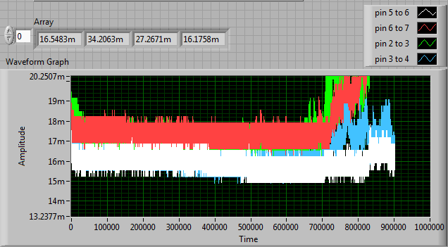

More recently I was taking some measurements of contact resistance for some relays to watch them age and I used a PXIe-4141 for 4 channels of simultaneous V & I measurements. My accuracy requirements were pretty loose so I was running very fast to reach close to a million cycles without taking too much time. Here is a plot of some of my data with Ohms vs Cycles as the axes.
I was using a 100uA aperture time, a 1ms source delay, and +/-50mA current limit to bring the voltage over 1mV. I did not run an error calculation for this test because I was mainly concerned with the trends as opposed to the absolute resistance, but slowing down the measurements would help!
