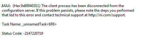

After the process has been disconnected from the server. I take that as meaning, my program has lost its connection to MAX, it looks like this:
Now when I retry my "set power supply voltage" method I am greeted by another exception, reporting that there are no analog output channels and this makes sense because we've lost connection to MAX...

As far as I can tell this disconnection is random and making 100 calls or 10 calls makes no difference. On one instance, I was able to perform almost 600 test cycles (which would have at least 10 or more calls to MAX). The test cycle that the above screen shots came from only had 17 cycles.
