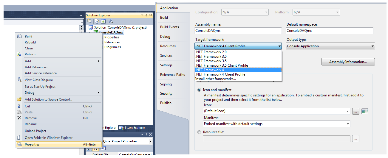

3)      Check the target framework

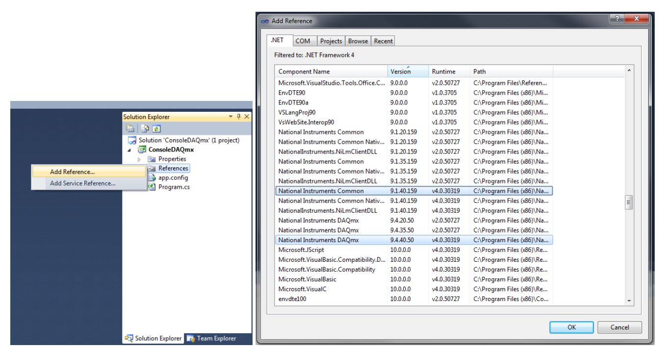

Framework.PNG4)      Check that the reference match the version of the driver that you have install.

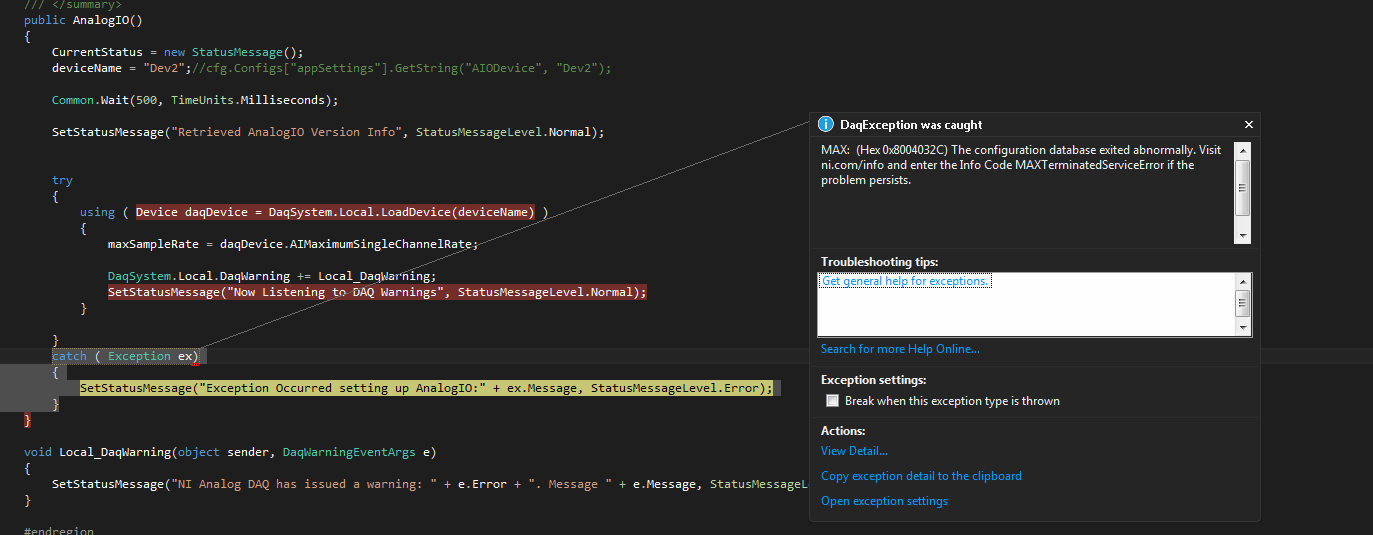

I was about to do some debugging on my one Windows 7 machine today and this happened:
I tried to open MAX itself and it refused. It generated a log and dump file which I have attached.
I was able to uninstall the entirety of the NI software and perform a reinstall from the 7.0 installer. This remedied the problem. I wonder what, if any, ramifications this has/will have on the disconnect issues I've been having...

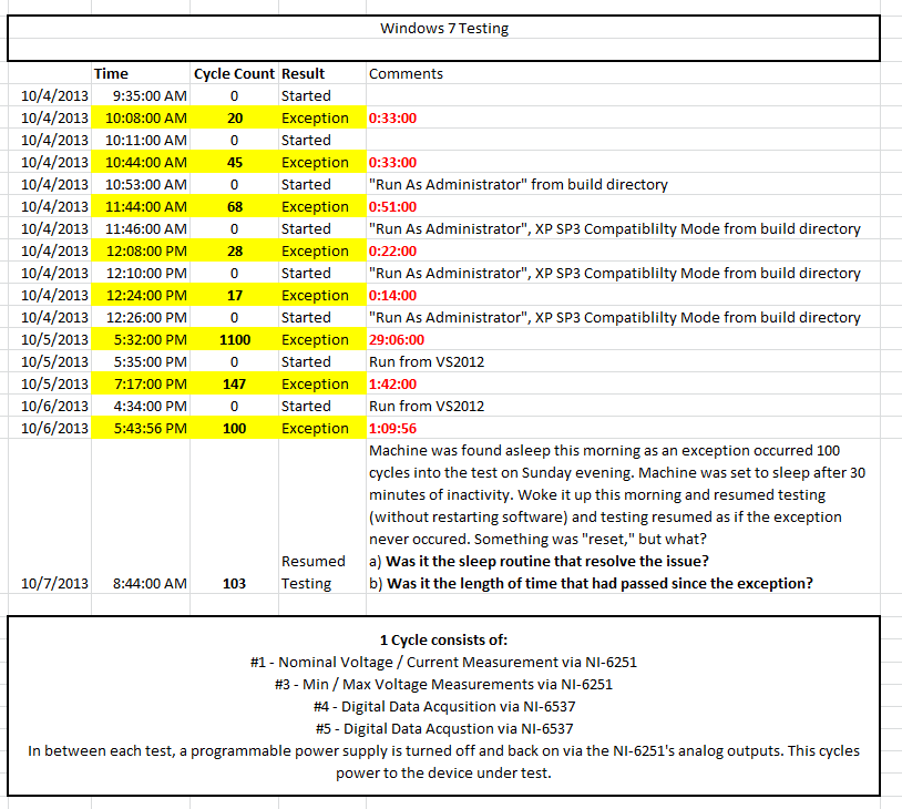

Good morning everyone,
I had the opportunity to do some extended cycle testing on Friday and over the weekend.
Earlier in the week I extraced the NI data acqustion aspects of code from the main program and created a smaller program that simply acquired analog voltage data, computed averages, then collected digital data and computed some items based on that data. I had this collection and analysis routine set inside of a thread and just looped it until an exception occured. I believe I got to about 4000 test iterations before I stopped the test as the machine was otherwise needed. This leads me to believe that the problem is not within the National Instruments DAQMx assemblies. To be 100% sure I should probably let that test run over a weekend but 4,000 iterations is a pretty good indicator.
So this leads me to believe the problem has something to do with Windows 7 and the .NET framework.
On Friday, I had access to two machines. One Windows XP and one Windows 7. I put the same version/build of the test software on both and let them run.
The Windows XP machine did not encouter a single problem. It completed 425 test cycle of data collection and analysis. I couldn't let it run over the weekend as the machine was needed today. However I was able to run the Windows 7 machine over the weekend and it encoutered a number of exceptions as I expected it would. I was trying to get a grasp on frequency of exception thinking that perhaps there was something there.  I've attached my findings. In red is the amount of time that had passed since starting the test run. I dont see any real pattern or predicitabilty to the exception.
On Sunday, I found that the exception had been thrown from the previous round of test. So I restarted the software and began testing again. About an hour later it threw another exception and stopped testing. I didnt check the machine again until this morning. However what I discovered that the machine had gone to sleep. I woke the machine up, didnt see the exception (it was behind the testing window) and I resumed testing. And it worked. Normally if I try to resume testing once the exception occurs...it just throws more exceptions. So SOMETHING restored the broken connection between our software and the NI MAX server. Either the act of the computer waking up from a sleep cycle OR the amount of time that had passed since the exception occured resolved the problem. While this doesnt give me any clear answers, it is certainly interesting. Since resuming testing the machine has so far accumlated an additional 57 cycles and is still going.
