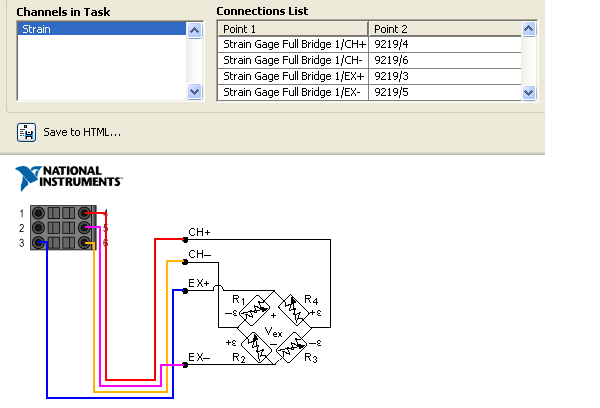

So for a full bridge configuration would each of the 4 strain gauges need to be powered and read seperately, using 4 serperate channels of the module?
Jamie
(4,856 Views)
No, you would still use one channel and the strain gauges will be powered from the same internal source. So for 4 strain measurements you need 1x NI-9219 and 16 strain gauges . See the attached connection diagram implementing full bridge completion on the 9219.
