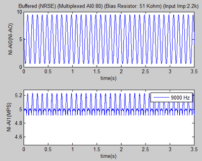

HI Lynn,

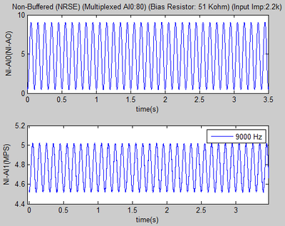

Here is the new test (based on the test2) that you recommended: The one with 2.2 Kohm input impedance (simulated by placing 2Kohm resistor in series between AO and AI). The results are as one would expect - significant ghosting effect is observed.
Below are behaviors with both AI0 and AI1 externally driven by a different card's NI-AO channels with 2.2Kohm resisters in series. One kept fixed at 5v and other with "NI-AO" input (i.e... 10 Hz sine wave from external NI card)
Buffering does improve results a little but still unacceptable.
Note that the buffered waveform obtained here is very similar to the one obtained from real MPS sensor (in the previous page).
Message 43 of 51
(4,102 Views)
Vikash_Kumar,
I think that test confirms that your sensors really do have a 2000 ohm output impedance. The datasheet was vaguely worded.

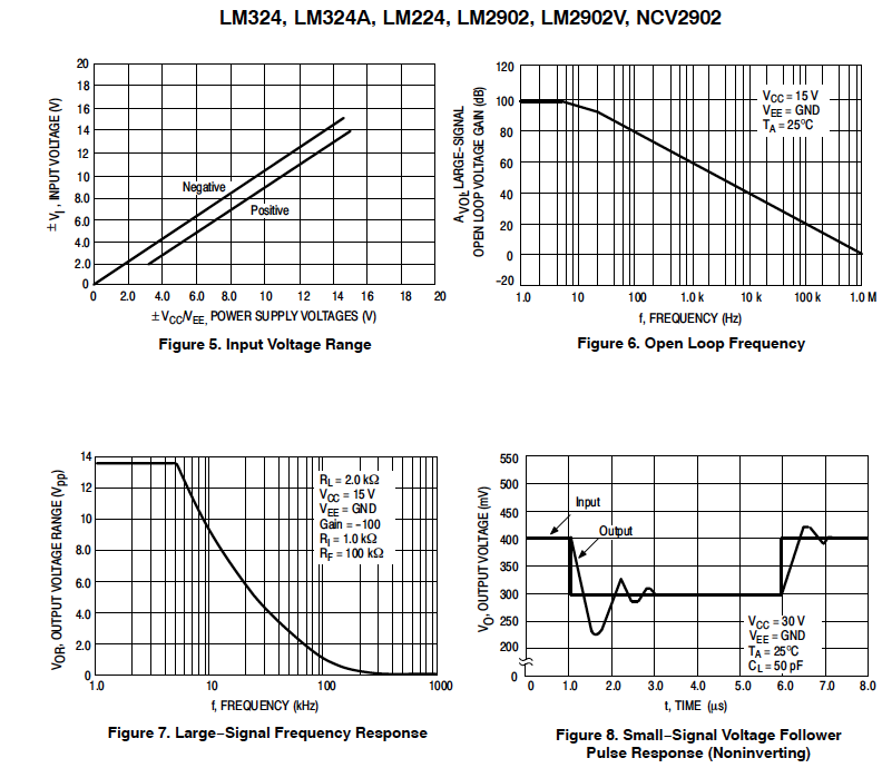

I suspect that part of the problem is that the LM2902 is not a very good buffer at higher frequencies.  As the open loop gain reduces at higher frequencies the effect of feedback at reducing the output impedance is reduced. The large signal frequency response begins dropping at ~5 kHz and the open loop gain is about half of the DC gain at that frequency.  While it is not straightforward to estimate the output impedance at higher frequencies, the result is consistent with the buffer impedance increasing with frequency.
Here is how the output impedance a much faster op amp (LF355) behaves over frequency.
If you have a faster op amp, see if that helps.
Lynn

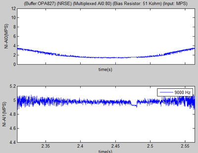

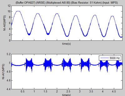

And we are back to the MPS sensors on all lines.
Here is the effect of OPA827 as buffer.
Here is zoomed view near the oscillations
