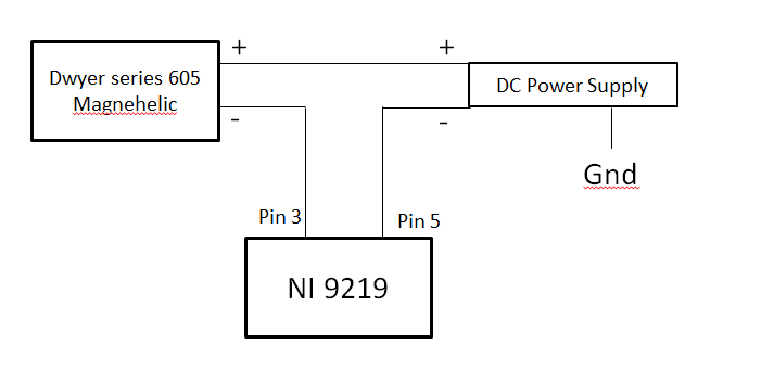

Below is the diagram.  Attached is a document for the Dwyer Magnehelic sensor which is providing the current we're attempting to measure.

It does look like you have the wiring configured correctly.
