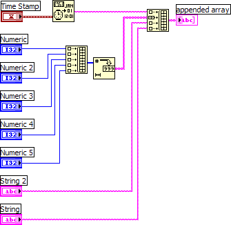

    I want to write one line of data containing both integers and strings into an excel spreadsheet.  This set of data includes 24 integers, 4 strings and a time stamp.  I could, convert all of my integers and time stamp into strings, then build an array and write to spreadsheet, but it gets so cluttered with 24 conversions.  is there a better way to do this without having to convert my data into the same data type?

You don't need a separate conversion for each numeric. Use a build array and wire the array to Number to Decimal String. This (and the other string conversion functions) can have an array as an input.
