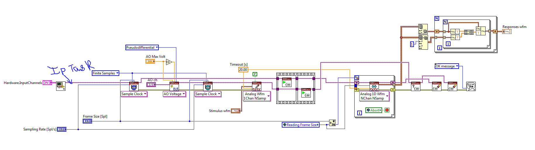

Below is the Acquisition code that I have written:
The issue is that when I use the I/P channels on the same card(4461 or 4492) then the code runs fine, but if I use the input channels on both cards simulataneously then I get an error message:
Error -200106 occurred at DAQmx Read (Analog 1D Wfm NChan NSamp).vi:
Possible reason(s):
Property must have the same value for all channels on this device.
Property: RefClk.Src
I have tried setting the Reference clock to "Onboard clock" but I still get the same error.
What should I do to reslove this issue?
