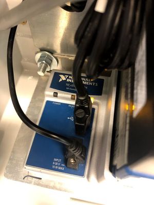

The device is not detected in Windows Device Manager. I tried different cables that works for another thing, but it didn't work. I also tried another ports, used another computer, which didn't work. The device was also not detected on another computer. However, when I power on the device it seemed a trigger was created so the Device Manager refreshed. Unfortunately, the cDAQ-9174 was not detected.
It really confused me that the active LED is on amber, but the power LED is off.
I think the most strange thing. If the power is supplied I think the power LED should be lit. But if the power is not supplied the active LED wouldn't have been lit. IMG_2929.jpg
