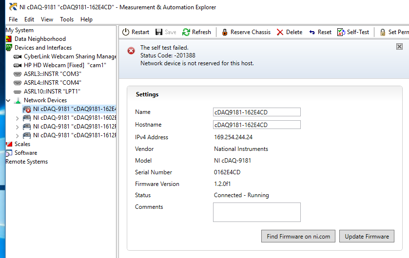

cDAQ9181 error code-201388
Where can I find out what these error codes mean?

Solved: Had to un-reserve and then reserve to this computer. Works fine now.
But I still want to know if there is a place to look up error codes.

Glad you found a fix. But the description leaves me a little wanting. Did you have to use a develop computer to unreserve and then the application computer to reserve your cDAQ? I have run out of time today to test this.
