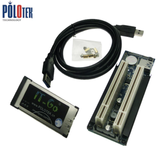

Can i use like this converter?
PCI to expresscardPCI to expresscard

Let me try to summarize your discussions,
  1. Using USB to PCI converter (don't know if it exists) would not work with PCI DAQ since this instrument solely relies are PCI bus features and timing specifications for functionality
  2. The image you posted is not a USB to PCI converter but rather an ExpressCard to PCI converter over USB cable
#2 - I do not know completely about the ExpressCard specifications to say if it will work. If you can afford it, I would suggest you take the risk and give try (theoretically it would work).
In any case, NI will not provide support for getting their devices to work with aftermarket modification products and if your instrument is damaged, it will be your sole responsibility.
