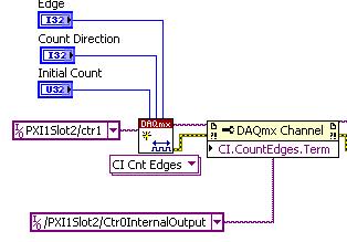

In general you should avoid connect/disconnect terminals.  They are used to create/destroy a semi-permanent route that is not tied to a DAQmx task.  My understanding is that you want to generate a signal using one counter and count it using another.  You can do the routing you want through the normal counter API by setting the edge counting source to be CtrNInternalOutput.
Here's a screenshot of what it looks like in LabVIEW.
Message Edited by MarkGrot on 03-30-2010 11:12 AM

While it is possible to use the Connect Terminals functions to accomplish what you need, the preferred method is to simply tell your Edge Count task to count the InternalOutput of the other counter.  You can do this with the DAQmxSetCICountEdgesTerm function, assuming you are using the C API.  For example:
DAQmxSetCICountEdgesTerm(gTaskHandle, chan, "/Dev1/Ctr1InternalOutput");
The Connect Terminals function is not tied to a specific task so it is easy to leave terminals connected by mistake (a device reset will take care of any undesired connections that might remain if you forget to Disconnect the terminals).  For this reason it is generally recommended to use the above method to connect the two lines rather than the Connect Terminals function.
