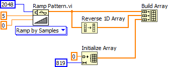

Building on the points already made by altenbach, 12 bits means 2^12=4096 discrete digitized voltage levels.  The most appropriate voltage range your device supports is 0-10 V.  You'll only be using half that range, so you'll have 2048 discrete voltage levels to work with in the 0-5 V range.  That makes discrete increments of about 2.5 mV.
You'll be going up and back down that triangle in 5 seconds, so you can *usefully* change output levels at a rate of only 4096 changes / 5 sec = 819.2 Hz.  Like altenbach said, nowhere near 1 MHz.
So if you set your sample rate for 819.2 Hz, you can hit every available voltage level with a single sample as you ramp up from 0 to 5 and back down again.  Then append another 819 zero values at the end to occupy the 1 second between triangles.
Here's how it'd look in LabVIEW:
-Kevin P
