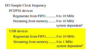

The error you are receiving (onboard device memory underflow) is a symptom of not being able to transfer data quickly enough from your PC's memory to the FIFO on the USB device.  The 1 MHz limit that you mentioned earlier is actually the maximum rate you can stream data continuously to the USB device (due to the high latency inherent to USB transfers) and doesn't have anything to do with the max frequency of the counter outputs:

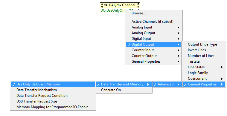

The on-board FIFO is 2,047 samples for DO, so if you would like to continuously regenerate a waveform that is 2047 samples or less at the full 10 MHz then you may do so by enabling the following property node on your DO task:
