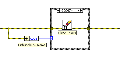

need to trap counter timout error from usb-6221
I am programing an application that will have intermitent frequency inputs.  What i need to do is trap the timeout "Error -200474 occurred at DAQmx Read (Counter DBL 1Chan 1Samp).vi:1" rather than having it stop the program.
How can i do this?

Hi Mitch,
Welcome to the forums!  Here's one way you can clear the timeout error:
John Passiak
