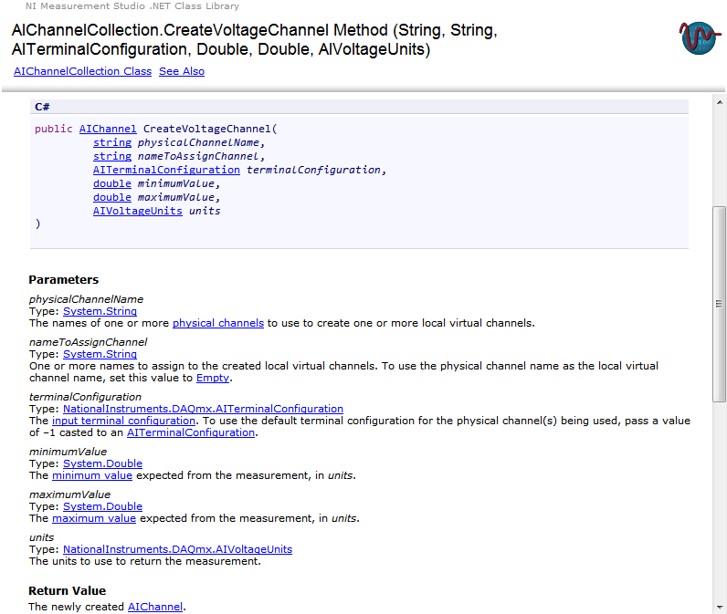

Hi Victor,
The documentation you're looking for is in the NI-DAQmx .NET Framework Help (see here).

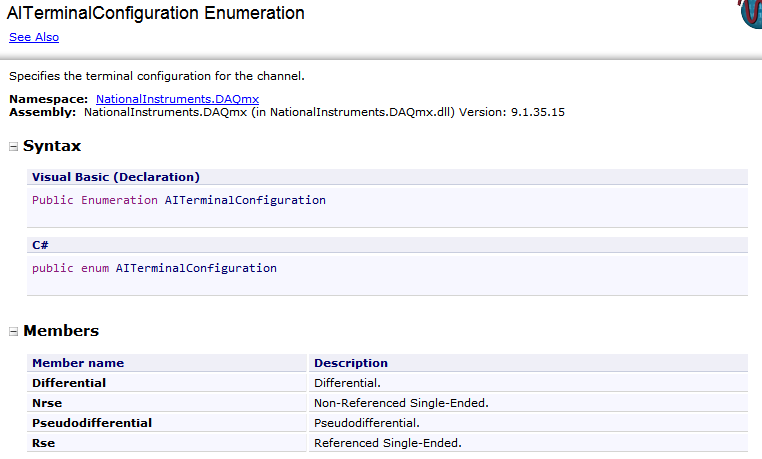

Here's a screenshot showing the page of interest:
Passing -1 and casting it to an AITerminalConfiguration will give you the default value, which I believe for the 9205 should default to Differential (you may want to verify this).  The members of the AITerminalConfiguration Enumeration are as follows:
