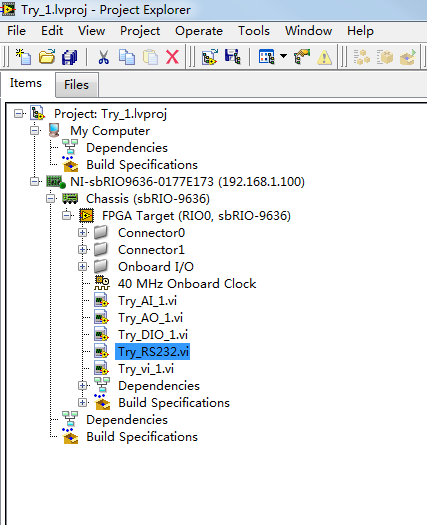

ok, my problem is to apply the modbus library on sbRIO9636.
At first, I created vi from the example "MB Serial Example Slave" under the position of FPGA which will not make it works.
Then I created vi "MB Serial Example Slave" under the position of Chassis(sbRIO9636), the project will include the relative subvi autonomously.
After that, the processors on the sbRIO9636 can support this modbus vi "MB Serial Example Slave" as the picture shows below:
