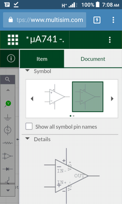

For the generic/virtual 5-Terminal operational amplifier we can simply choose the appropriate symbol from the Configuration pane as shown in this screenshot

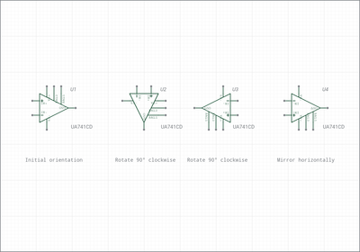

For real operational amplifiers (with part numbers such as μA741 and LM324), there is no alternate symbol with the input terminal positions interchanged. We might try to rotate by 180° (90° twice) then mirror horizontally. However, Vs- goes to the top while Vs+ (along with balance terminals) goes to the bottom (see the image below). Note also that the names of input terminals (IN+ and IN-) are upside down.
