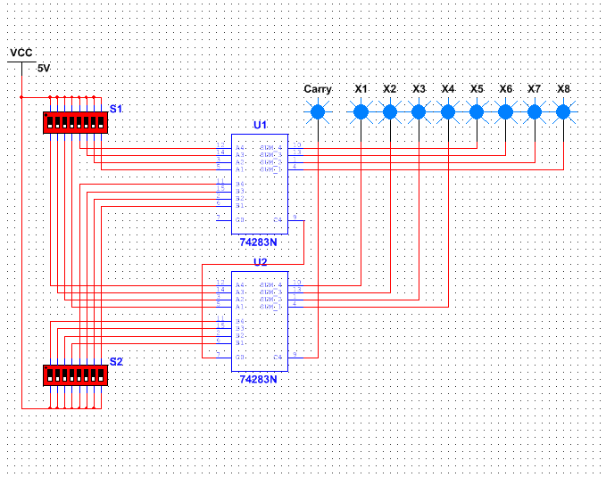

Hi, I am sorry that I wasn't clear enough. I need to add/subtract 2x8 bit numbers. So i need 16 inputs(8 for each number). I know multisim supports for 8 inputs. Is there anyway (except using switch/direct connection to Vcc and Ground) to extend it to 16 inputs to enter these two numbers?

Hi Hannaneh
I'm not entirely sure what you mean. If you mean you want to modify an exisiting IC, then you cannot do this. However you can create your own if you understand the logic, using the existing ICs to acheive this. For example you can acheive the adding of 8 bit numbers like this
I have attached the file with this circuit design for your examination.
I hope this helps!

Thank you so much for taking your time. It helped a lot 🙂
