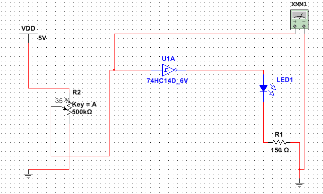

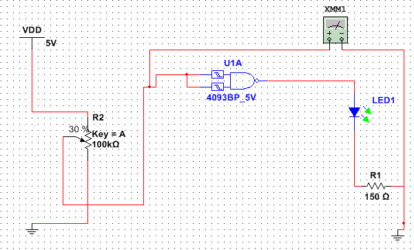

Now I have to ask something from my original idea:
I was thinking of OP-AMP as LOGIC producer, I realized OP-AMP is an analog device. Reason to utilize was that I needed some tolerance at inputs of a logic gate. Later I relaized that a schmitt inverter such as 74HC14 can provide tolerance at input because of built in schmitt.
Now if considering water conductivity to make a logic’s input to LO or HI I have following considerations:
-        Use ACTIVE LOW OUTPUT SCHMITT INVERTER ( such as 74HC14)
NOTE: water conductivity at input of the inverter makes the input LO to make the output HI
-        Use NAND with Schmitt inputs such as  CD 4093 but make it a NOT gate by shorting the two inputs together
NOTE: water conductivity at input of the NAND makes the input LO to make the output HI
Q. What difference can it make in above two scenarios if I use inverter Vs if use NOT-GATE based on NAND  both have Schmitt?
Q. should use CMOS or TTL family? Which would be better suitable
Q. what supply rating devices would be better. These devices are available in 5V and higher ratings. Higher voltage rating device like 10V  ( series 4000 and 74C00) their input will have more margin for voltage levels. So a slightly larger current we can pass through water probes so I think that would be better with contaminated probes.
Q. Also need to consider the length of wire from sensor probes to circuit is approx. 10m and it may pick noise in between. It will pass nearby the electrical water pump. I am thinking of using CAT5 ethernet cable for this purpose, it is readily available and has cross twisted pairs. I think therefor, AC signals would be better than DC because DC LO/HI can be fooled easily if my wire picks noise.
Q. In Multisim what is the difference between Vss and GND and Digital GND ?  I used GND only and it works for all CMOS devices. is it necessary to use VSS also?
The capacitive probe idea I would try soon.
Thanks for all the support.

The coaxial capacitor would be made of metal. Copper pipe is one possibility. If the tank is made of metal, using tubing of the same metal would tend to minimize the possibility of galvanic corrosion. Both corrosion and mineral deposits may occur. I think the capacitive sensor will be less sensitive to those effects than a conductive sensor would be.  In principal you could use insulated conductors for the sensor which would completely eliminate the corrosion effects. The disadvantage is that the insulation changes the capacitance. The calculations I did show that using insulated pipes for the sensor would result in significantly reduces sensitivity.  Considering how cheap two pieces of pipe are, it woudl probably be easier to replace the sensor very 5 years than to try to protect it enough to make it last ten.
Your microcontroller can easily measure the frequency (or period) of the oscillator output. Or you could build some counter and timer circuits to do the job.  Since you specified that you only need to know the level to one part in eight of the total depth, the requirements on the measurement are not very stringent.  Near full depth I estimate that a change from 2.7 m to 3.0 m would change the frequency from 314 Hz to 279 Hz or about 10%.
Now to your Schmitt trigger circuit questions:
There is essentially no difference between the 74HC14 and the 4093 circuits. Because the 4093 uses two inputs you have twice the input capacitance and leakage currents.  You can eliminate those by tying one of the 4093 inputs high and only connecting 1 to the sensor.
CMOS or TTL? For this application CMOS is the clear choice.  TTL is a current input technology. You need to sink current (to ground) to pull an input low on a TTL device. CMOS requires no input current except for pA of leakage currents. Given the low conductivity which might occur in the water, TTL wold be a very unreliable choice.
Supply voltage? The larger currents are probably better for a conductivity probe. On the other hand, if the rest of the system is constrained to use 5 V (to be compatible with the microcontroller for example), the added level shifting required might make keeping everything at 5 V more convenient. You could make the area of the sensors larger to get more total current.
Cable type? CAT5 cable should work.  You may still need to do some filtering or averaging to reduce the power line interference.  Try to route the signal cable and the power wiring so they are not parallel and are as far apart as is practical.  It requires more circuitry but using AC excitation for the conductivity sensor and synchronous detection can allow operation in the presence of substantial amounts of interference.  Another option is to put the Schmitt trigger circuit at the tank and run the output back to the control board. Then the signal on the long cable is a high level, low impedance signal which is much more immune to noise problems.  These comments apply generally to the capacitive sensor as well. A CAT5 cable has about 52 pF/m of capacitance and RG-58 coaxial cable has about 82 pF/m.  Either of these would add an offset to the minimum capacitance of the sensor if the oscillator is remote from the sensor.
I do not have Multisim, so I cannot tell you how they have defined the supplies and grounds.
Lynn
