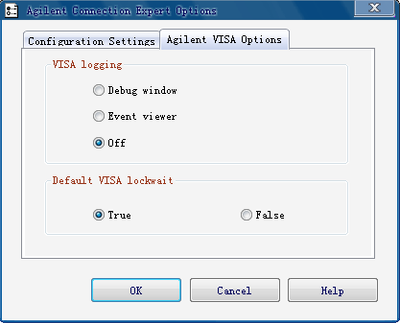

VISA.png如左图,在Agilent Connection Expert(14.0)的tools 选项下没能找到Enable Agilent GPIB cards for 488 programs.而MAX设备和接口如下图:M.png

This is the version Agilent Connection Expert that I used...
