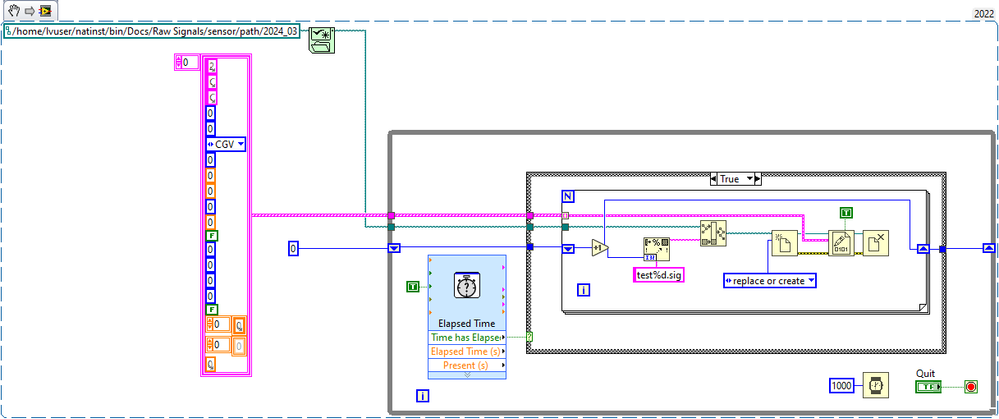

One of my prime suspects for the crash (but one which does not so far display any obvious difference between 2020 and 2022) is a very simple operation: every 2 hours the application creates, writes *and* closes 100 unique 62 KB files. If I disable this operation (it is an optional logging feature so it can be turned off without rebuilding the app), or make it write to the same 100 files over and over instead, the application is stable (i.e. runs beyond test period..). It seems the file operation has an issue, and I am thinking it might be fragmenting/leaking memory.
NI Max will report, even just before the crash, that there is plenty of memory available and free disk when the crash occurs (and low (normal) CPU activity as well). The LVRT process is reported by the OS to use a stable amount of memory, around 26% of it...But if I use cat /proc/meminfo and cat /proc/buddyinfo I can see that every file created, written and closed shrinks MemFree, and the number of larger memory blocks goes down while the number of smaller ones go up until they also diminish. The crash seems to occur around the time when MemFree will reach 0.
If the application is reduced down to just this file operation and it is run it at an accelerated pace its effect on memory is easily observable (here I create 36 unique files (21 KB each) every 2 minutes):
At the start of the test the memory reports on a cRIO-9030 e.g. typically look like this:
Meminfo:

So, Memfree is approaching 0, but MemAvailable is still just slightly down. The number of large memory blocks is replaced by many small though, which eventually disappear as well. The latter seems less healthy...(?)
In the actual application there is surrounding logic that checks if the disk is getting full or the number of files in a given monthly folder is getting high and if any of these occur a decimation process kicks (deleting every 4th file e.g.). So for a split second I thought I had found the culprit when I saw this comment about a leak in Get Volume Info...but that was on VxWorks: https://forums.ni.com/t5/Real-Time-Measurement-and/Detecting-external-USB-drive-mounting/td-p/182048...
During testing the decimation logic only kicks in on the smallest cRIO the 9063 due to its limited disk size, and unlike the other targets it does not crash. If I manually delete files on the other devices I can see that MemFree goes up again. It seems files hold memory even though they are closed, but this memory is freed if the files are deleted. Buddyinfo also indicates that larger blocks return.
For the Linux RT experts out there; Is this expected behaviour? Or have you seen similar crashes related to creation of many files on RT and know what might address the issue? The fact that disabling these file writes in the application eliminates (or at least significantly delays) the crash makes it look like I am on a good track, but then I would have expected to see a difference between 2020 and 2022, which I have not yet (still running a comparison test).
