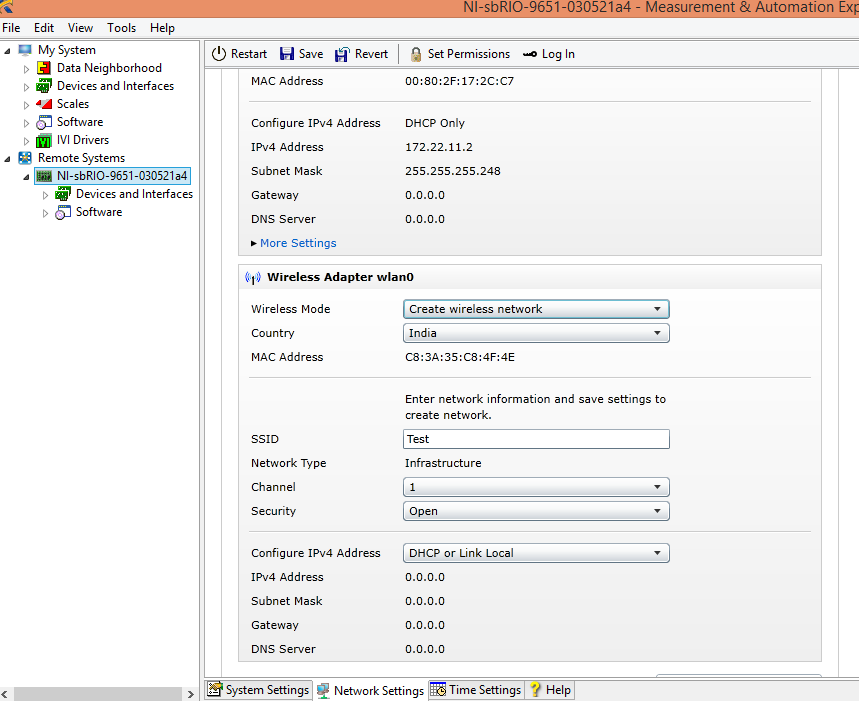

I have been trying to communicate via USB wireless modules as well. After a few MAX restarts it did show up in MAX. I am facing some issues with the dhcp network and will report back if the issue persists.MAX with wireless module.PNG
