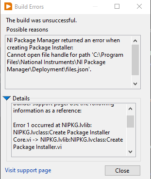

Today I went to create a NI Package from LabVIEW 2020 SP1, and during the build process I received an error saying

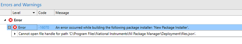

I had never built a package through LabVIEW before, but I have through NI Package Builder, however I'm using a new computer, so I switched over to the NI Package builder, and tried to build a similar package (from a LabVIEW EXE), and the package built fine, but when I went to build an installer I received a very similar message:
Indeed, when I check that path, there are no files there at all! the directory doesn't even exist....
I've done the following:
- Checked with 32/64 bit software
- Ran in Administrator mode
- Uninstalled/Resintalled BOTH NI Package Manager AND NI Package Builder
Nothing resolves these issues... I'm running 20.6 software for Manager/Builder, and LV 2020 SP1.
The system is VERY fresh (just started working from it in February of this year.  I have an older system where I could use the package builder just fine... I also checked there and there were a variety of files inside the "Deployment" directory...
Any suggestions on what to do here?
This is very frustrating...
