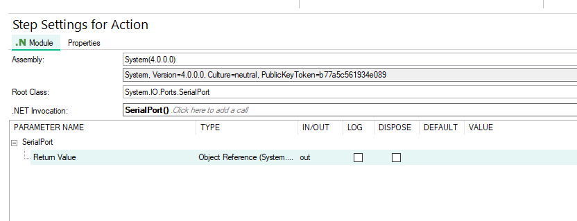

Using mscorlib Assembly in the module, I don't see the selection for System.IO.Ports.  Trying to use with a .NET SerialPort.  Has anyone had success in using within a sequence directly or do I need to create a wrapper DLL for this?

It is possible as shown below,  you've been looking at the wrong dll, you need to select System.dll

Thanks @santo_13.  I actually found it soon after sending the last post.  Thanks for the response. 🙂
