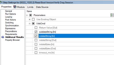

Hello together,
i would like automatically activate two"Additional Results" hooks, for all Steps in an SEQ which use the DLL UdsSoma.dll
Is this possible in TestStand?
Icing on the cake would be, if i also could insert a "Condition" Expression into the two "Additional Results" - but that is not that critical.
Thanks a lot in advance for your help!

Thank you for your commands!
I used the example "Creating a Sequence File iteration"  this is a big step in the right direction.
Thank you!
I used the two if-checks you suggested:
Parameters.Data.AsStep.AdapterKeyName == "DotNet Adapter"
and
Parameters.Data.AsStep.Module.AsDotNetModule.ClassName == "UdsSoma.UdsSoma"
But now i face the problem, that i need to set this Variable in order to change the "hook" described in the screenshot above.
RunState.Step.TS.SData.Calls[1].Params[2].AdditionalResults.Input.CheckedState  to the value "2"
But the example SEQ passes the STEP as "Parameters.Data.AsStep" -- but passed as Reference in this way i could not find/access the variable ...SData.Calls[1].Params[2].AdditionalResults.Input.CheckedState and so on.
Do you have an idea how the set the value of this variable?

Here the marked in color which lines in the expression match the result (above)
Message 9 of 9
