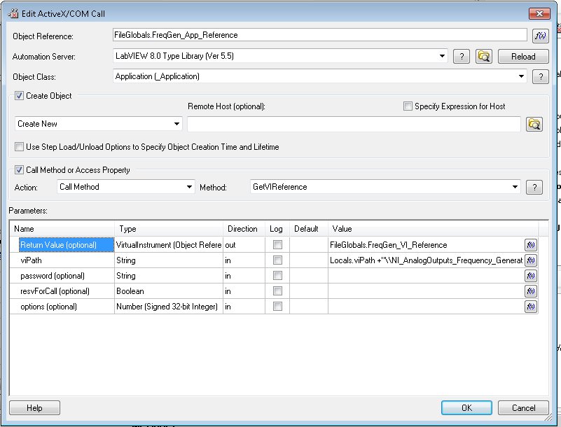

In my Development system I've create a VI that I need to be running continuously during a sequence so I Create it and call it using ActiveX controls. Works fine in my development system with both the LabVIEW development system and the LabVIEW runtime engine.

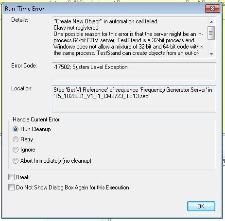

When I try to create the reference to the VI on the deployed computer, I get this error:
There is nothing in this system 64bit. It's Windows 7 32bit, TS / LV 32bit.
This is my automation call:
Which as I said works fine on the Development Computer. What have I failed to do on the deployed computer?

Hi Dave,
Have you seen this resource?
TestStand Error -17502: "Class not registered, System Level Exception"
http://digital.ni.com/public.nsf/allkb/901B5E1C33A102A18625671C007C501F
Try using late binding and see if that clears the error.

Yes, it is checked.
I've put in a service request to NI and the application engineers are looking into it, but if if there are any other ideas I'll give it a try,

No solution to the original problem found. I got around the issue by using wrapper Vis to control the VI in question through Application Control VIs. Essentially doing the same thing I
was doing in TestStand directly before.
