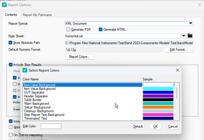

In the Report Options I found which Style Sheet I was using: tr6_horizontal:

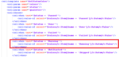

I opened tr6_horizontal and every place I found a status for "Passed", I copied and replaced the text with "Warning":

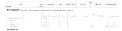

This kind of worked...It got the color to change(yellow) in the Batch File/Report (I'm using the batch model for this sequence):

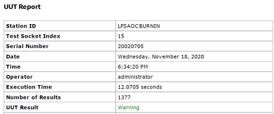

But the individual UUT Reports were unchanged(still green)...
I really don't understand why one report is changing and not the others...

What you are describing either means that :
- the Batch and the UUT Report are referencing different StyleSheets
- there are parts in the stylesheets which are different for the type of report being viewed
You can check the first option just by opening the raw xml and compare the StyleSheet reference
Do modifications made here
reflect in both types of reports?
