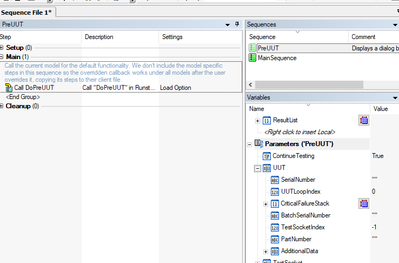

I'm new to TestStand and I'm sure this is an easy question. I'm using a custom serial number VI in testStand to, well, get serial numbers. I understand how to modify the PreUUT callback to use my VI, however, how do I programmatically get that number to show up in the filename? I'm sure there must be some property that needs to be set, but after much searching, I have not been able to discover that.

The serial number you read from the custom VI should be transferred to parameters.serialNumber.
You can use a statement step and add parameters.SerialNumber = locals.serialnumber ( assuming your VI returns serial number gets stored in locals.serialnumber). Thats it for the reports.
FYI...parameters.continuetesting decides if the sequence has to continue or stop testing.

Thanks for this input. I got everything working based on your suggestion.
