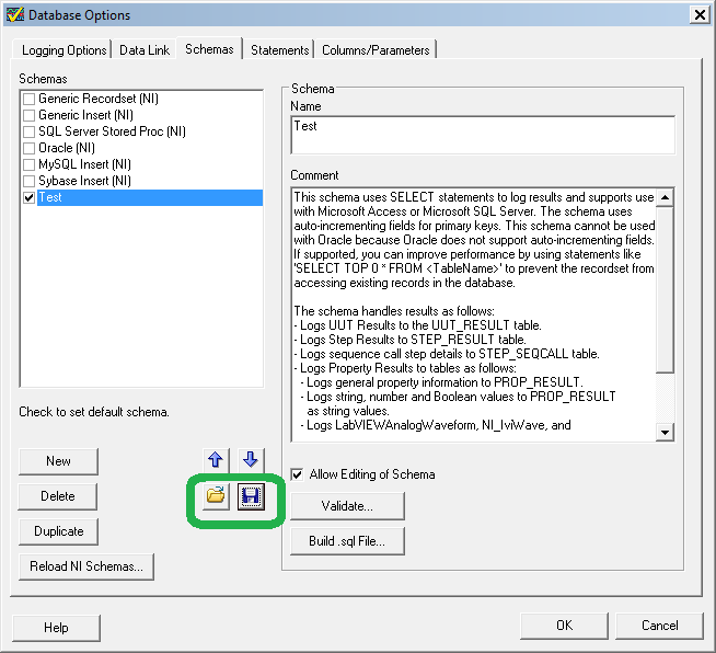

I'm tring to setup a second development station and I can't figure out how to install my custom database schemas.  I tried copying over the file below but it didn't work.
C:\Program Files\National Instruments\TestStand 4.2.1\Components\Models\TestStandModels\Database\TestStandDatabaseOptionsDef.ini
Are the  values set in the "Schema","Statement" and "Column parameters" saved in this file?
If so, why isn't copying the file working?

You can export and import database schemas using the save and load buttons in the dialog:
