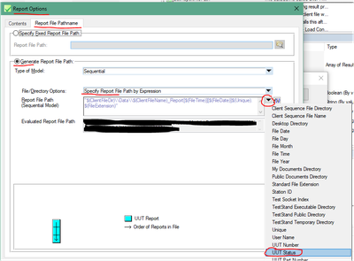

Check for Configurations/ Report Options, where File Path can be Configured based on Expression.

Well I know this document but the question is "which parameter in the callback ReportOptions -> Parameters -> ReportOptions" do I need to change and how the expression looks like?

Depending on which model you are using, the expression that you would need could be one of these:
Parameters.ReportOptions.ReportFileSequentialModelExpression
Parameters.ReportOptions.ReportFileParallelModelExpression
Parameters.ReportOptions.ReportFileBatchModelExpression
In my test it looks like this: "$(ClientFileDir)\\Data\\$(ClientFileName)_Report[$(FileTime)][$(FileDate)]$(Unique).$(FileExtension)"

I think you are misunderstanding TestStand variables.
Parameters.ReportOptions.ReportFileSequentialModelExpression is the name of a variable.  This variable is an expression string so it has be formatted as an expression:
If you are using Sequential Model:
Parameters.ReportOptions.ReportFileSequentialModelExpression = "\"" + StationGlobals.ReportDirectory + "\\\\" + Parameters.ReportOptions.BaseName + "_$(UUTStatus).$(FileExtension)" + "\""
If you are using Batch Model:
Parameters.ReportOptions.ReportFileBatchModelExpression = "\"" + StationGlobals.ReportDirectory + "\\\\" + Parameters.ReportOptions.BatchBaseName + "_$(UUTStatus).$(FileExtension)" + "\""
Message 9 of 14
(1,932 Views)
now I implemented as you wrote but the report name remains the same. This means only the $(FileExtension) is written while the $(UUTStatus) is still missing. When doing everything within the report GUI it works but unfortunately not when doing in the ReportOptions callback.
