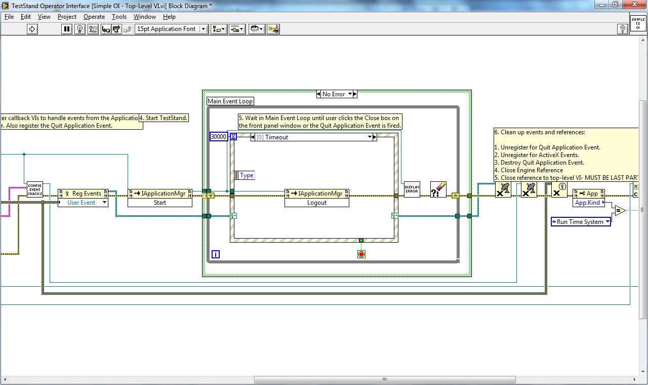

The easiest way I can think of is to modify the Timeout case of the Main Event Loop to call ApplicationMgr.Logout.
See the attached screenshot below, this is modified from the LabVIEW Simple OI. Note that I added a constant 30000 (30secs) to the timeout node of the event structure.
Also, I've attached the Top Level VI for your convenience.

Jervin,
Thank you for your help.
Your way is simple but I would like to have a control over the timeout. I would like to disable timeout at SETUP and enable timeout at CLEANUP. This will prevent timeout to activate during TEST UUT.

Hi VI123
Using the same architecture, you could modify the timeout to be a control/variable. Then in the setup/cleanup, send a UIMessage from your Sequence (or Process Model) and in your OI, register a UIMessage Callback VI that will get called when the UIMessage is sent. Update the control/variable from this callback VI.
