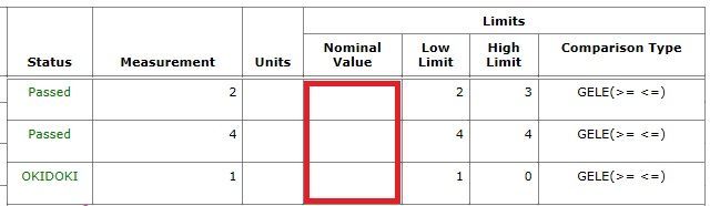

Is there a way to display the nominal values in the test report if there is a "GELE" comparison.
Currently, nominal values are displayed at EQT comparison only.
My setup is the default horizontal.xsl template which generates the xml report in Test Stand 2019.
I tried to modify the horizontal.xsl file, but without success so far.
Please is there any idea how to fix this?

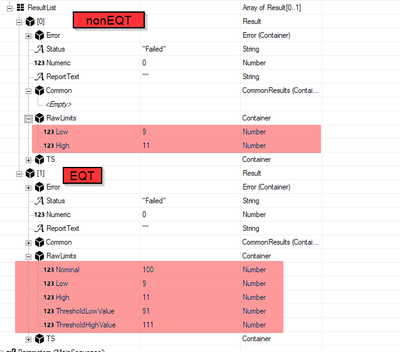

The ResultList-Variable is what matters for result generation.
In the screenshot you can see the difference between a EQT and a non-EQT NLT.
