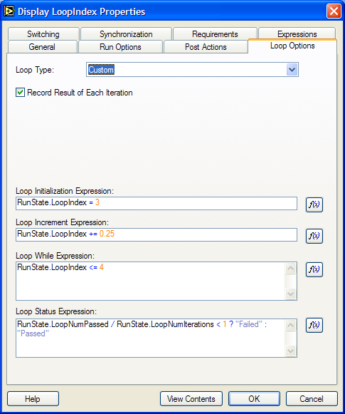

However, TestStand allows custom loops to be made where the LoopIndex is something other than an integer.  For example, I could make a loop that increments from 0.25 to 0.28 in steps of 0.01, as shown:
The problem is that if I query the LoopIndex from the API for each iteration of the loop, its value in each case is zero.  Basically, any fractional part is lost.

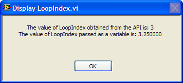

Here's a simple demo consisting of a single-step sequence and a VI, together in the attached zip file.  I've also included screenshots of the loop options and one of the iterations that shows the issue.
The option to pass it as a variable (as I have done in the demo) isn't an option in our real application, as I'm actually qerying the LoopIndex from the Process Model, not from the step itself.
I would be grateful if NI could let me know when this will be fixed.  It just needs the API datatype to be a double instead of an integer...
