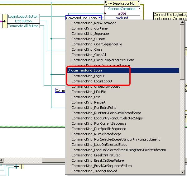

OnlyOne,
the button is disabled and greyed out by TestStand itself because you would run into problems as stated the post before.
To get around this, you have to connect the button with another function from the TestStand API. In order to do that, you have to open the "Simple OI - Configure Application Manager.vi" and change the setting like seen in the screenshot below to CommandKind_Login. Currently, it should be configured to CommandKind_LoginLogout.
But please note that relog antoher user during execution of a sequence can lead to problems in the execution. So it is not recommended.
hope this helps,
Norbert
