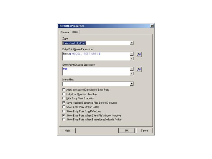

The buttons are only visiible when their functionality makes sense.  Until there is a sequence file open, you cannot run an execution entry point.
Allen P.

Also, there are several configuration options for entry points that can be set. These are available by getting the Properties of hte Entry Point Sequence in the Process Model. I've attached a link to seperate post on the topic here: http://forums.ni.com/attachments/ni/330/14616/1/EntryPoint.jpg
