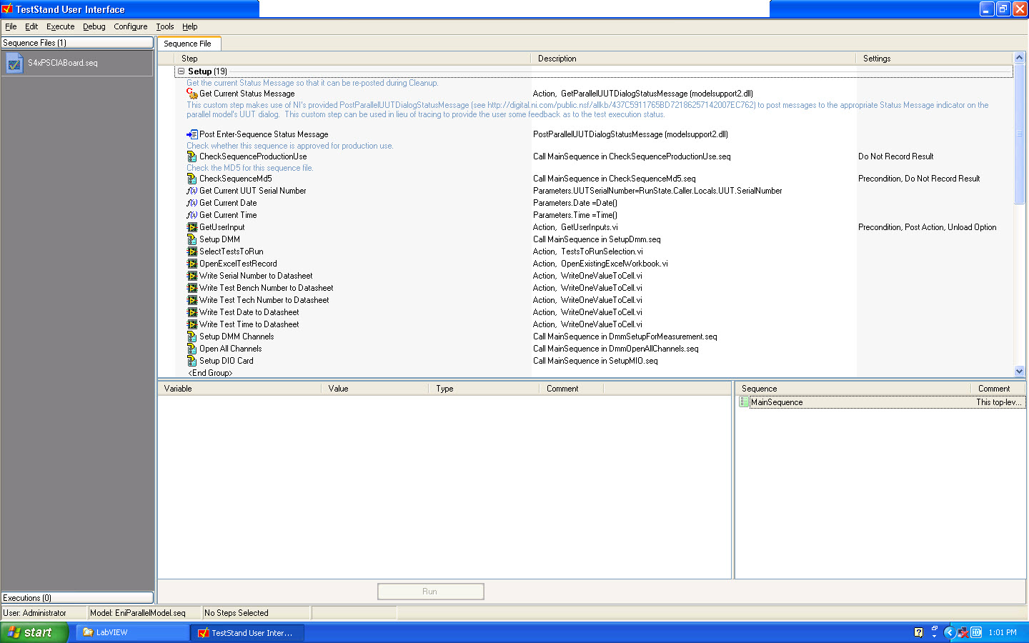

I am having this same exact problem, I was able to successfully deploy to a couple of test machines and not to another test machine. Has anyone figured out how to fix this issue? When I load up the sequence I am not seeing the Test UUT's or the Single Pass Buttons and where the Run MainSequence button should be I see a Run button but it is disabled. I can still run the sequence by using the Execute/Test UUT's or by right clicking on the left side where the sequence file is located and clicking Test UUT's. If I click anywhere in the center where the sequence files are located I get a Microsoft Visual C++ Runtime Library Error. I am using Labview 8.2.1 and TestStand 4.0 and my test machine is running Windows XP with all of the normal windows updates

You are likely running into one of the two issues documented in the following KnowledgeBase articles:
TestStand UI Controls do not work when Microsoft .NET Framework 2.0 SP1 is Installed
Why do I receive a Microsoft Visual C++ Runtime Error when Interacting with a TestStand User Interfa...
I would check the first one before the second one. Hope this helps. Please let us know.

Option 2 has fixed my problem. Thanks for the assist Manooch
