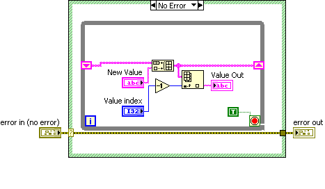

Here is an example of the solution:
Functional Global:
Glenn Ellis
(4,350 Views)
I think you missed the attachment
(4,337 Views)
Here they are
Funtional Global VI:
Reentrant VI
