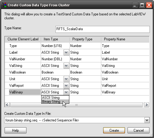

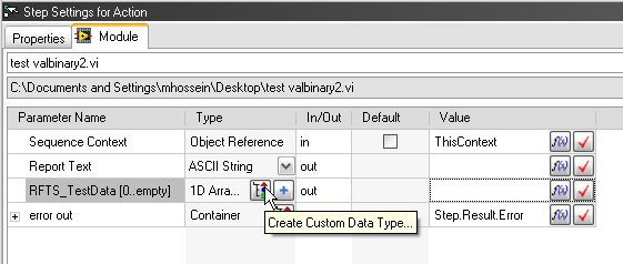

In order to pass a cluster from LabVIEW to a TestStand container, you must create a custom data type (container) that matches your LabVIEW cluster. The easiest way to do this is to use the "Create Custom Data Type..." button located in the Type column of the Parameters Table for your VI.
For example, your VI has an array of clusters as one of it's outputs (RFTS_TestData). Upon clicking the "Create Custom Data Type..." button, you will be prompted by the "Create Custom Data Type From Cluster" dialog. In this dialog you can name your custom data type as well as specify what type of string each string element of the cluster is supposed to be. Set the ValBinary Cluster Element to be a Binary String.

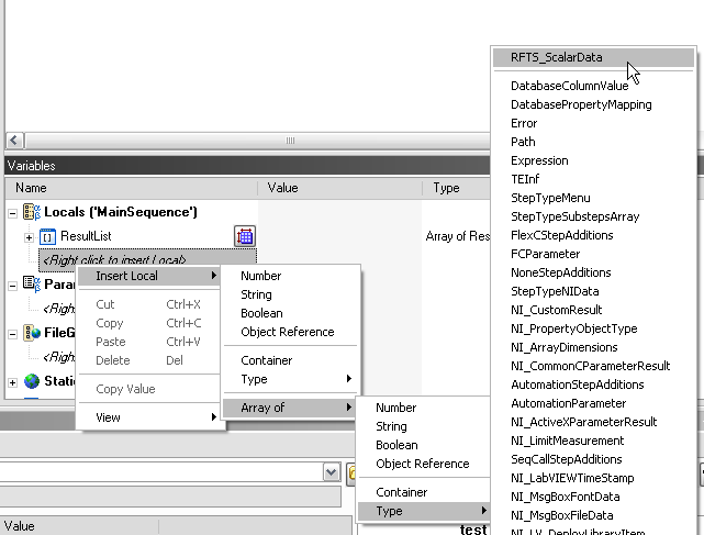

Once you've clicked the Create button, this new custom data type will by default be added to the current sequence file. You can then create an Array of this custom data type and pass it to and from TestStand.

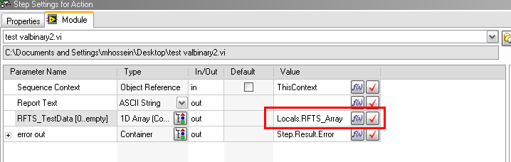

Thus, the TestStand destination of this LabVIEW cluster is : Step.Result.RFTS_TestData
This is done in a generic TestStand StepType, which doesn't know how many element the array RFTS_Data will contain.
The RFTS_Data is empty. If I had one element, there is no way to force the "Binary String" option within this generic StepType.
And If I could programmatically do this, I still don't know what will be the number of elements at execution.

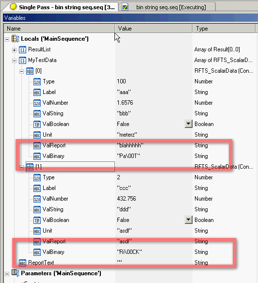

As Manooch references in his post, to illustrate his point I created within TestSTand an array of the same custom data type to store data passed out of your test valbinary.vi. For testing reasons, I also edited the VI to outputsome constant values to the cluster. (See the following screenshot). Notice that the last string (labeled ValBinary) in the cluster contains a hexadecimal string with a null character inserted as the 3rd character in the screen (before the actual end of the string).

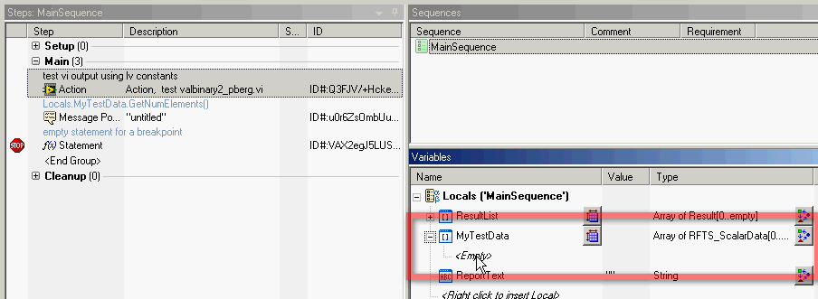

Here is a screenshot of the sequence file created that calls into the VI and then displays to the user the number of elements contained in the array coming from the VI.  Note that the Locals.MyTestData array is empty before execution of the sequence.
Lastly, as the sequence executes, I opened the Variables pane to show the contents of the Locals.MyTestData array. Here I confirmed that the "binary" string from LV was successfully passed into and stored by TestStand.
 Lastly, the message popup in the second step of the sequence indeed displayed a message indicating there were two elements in Locals.MyTestData.
This sequence was able to successfully execute even without manually specifiying a size of Locals.MyTestData beforehand; TestStand dynamically allocated elements as necessary to store the results of test valbinary.vi.
