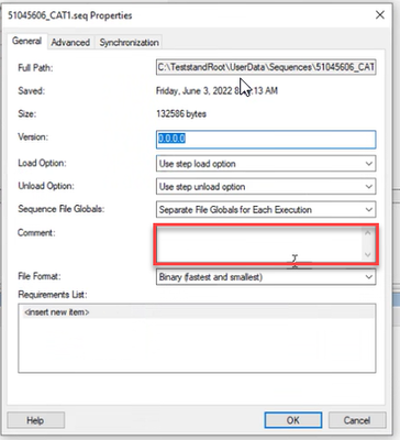

Just to be fully sure.
I'm new to TestStand so maybe I'm using the wrong words for what I want to achieve.
When I save a new version of a sequence file in TestStand, I can write a comment about the change I have made.
Is this comment not stored in the Sequence file?
