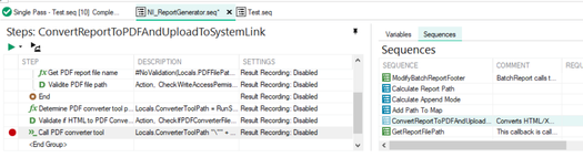

The PDF generation is done by the exe - the last step in the selected sequence :
If you feel this PDF converter is time consuming then you can try something like :
https://knowledge.ni.com/KnowledgeArticleDetails?id=kA00Z0000015CO4SAM&l=en-IN
Check how much time this VI takes to convert to PDF. If its faster than you can use this instead of the default step in the above picture.
