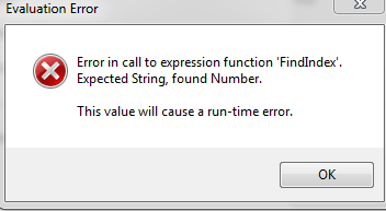

Hi All,
I used this function long before which was working for me, but not sure what i am doing wrong not able to get my work done.
This is my scenario,
I have a Local variable  1D array of String assume (Locals.XXX)
i need to get First element value
I used the Below syntax
FindIndex(Locals.XXX,1,True)
Advice me what i am doing wrong

Hi Palanivel,
Is the array an array of strings?  Perhaps you should use
FindIndex(Locals.XXX,"1",True)

The FindIndex function returns the index as a string, formatted as "[i][j][k]"; are you trying to use this or are you expecting a numeric index to be returned?
To get a numeric index, use the following expression:
IndexToOffset(Locals.Array, FindIndex(Locals.Array,"1",True))
