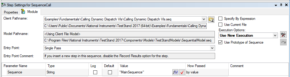

In a sequence call step you can specify a sequence file by either path or expression (specify it dynamically at run-time), then choose if you'd like to run it sequentially, in a new thread, or in a new execution:
There are some useful advanced settings under the button to the right of "Execution Options" - things like how to wait on this sequence to complete.
You could create one top-level sequence file that calls your other sequence files in this manner, and decides which ones to run based off preconditions or flow control steps. It would also be possible to write a custom LabVIEW UI that does something similar with the API.
