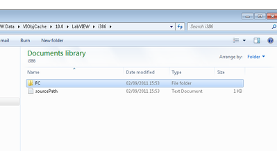

Alan -
Could you provide a screenshot of the Clear Compiled Object Cache dialog from your LabVIEW 2010 installation? Additionally, please provide a screenshot of the following directory: My Documents\LabVIEW Data\VIObjCache\10.0

Also, the directory you mentioned goes a bit deeper:
C:\Users\optest\Documents\LabVIEW Data\VIObjCache\10.0\LabVIEW\i386 - this directory contains the following:
C:\Users\optest\Documents\LabVIEW Data\VIObjCache\10.0\LabVIEW\i386\FC\E297999342396E6F185AA22D7DC103 - this directory contains the following:
C:\Users\optest\Documents\LabVIEW Data\VIObjCache\10.0\LabVIEW\i386\FC\E297999342396E6F185AA22D7DC103\9E7ACB34BC3F81D01A96855D9CBECAE1 - this contains the following:
Alan
Message 16 of 31
(3,478 Views)
